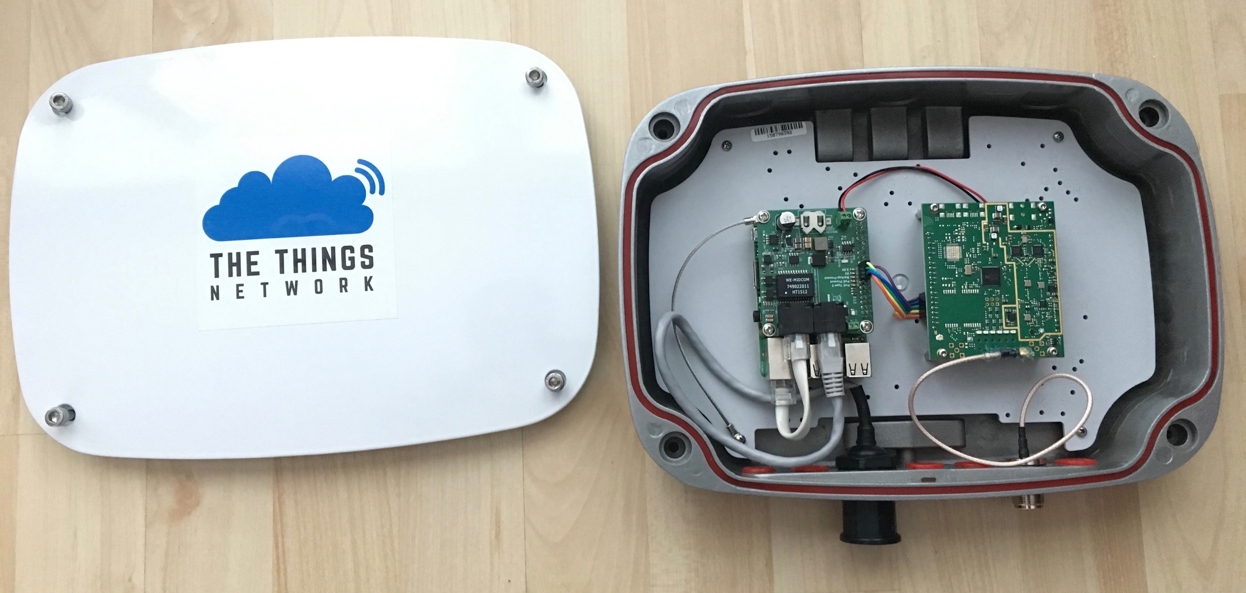

Just build my second IC880A RPI Gateway:
Still no hangs on my first one. I guess the metal enclosure, disabling wifi and bluetooth does wonders.
nice case.
where did you get it?
how could it be fixed at the wall or somewhere else?
Cable ties, towl.
https://www.wimoodshop.nl/product/436/RF-Elements-StationBox-ALU

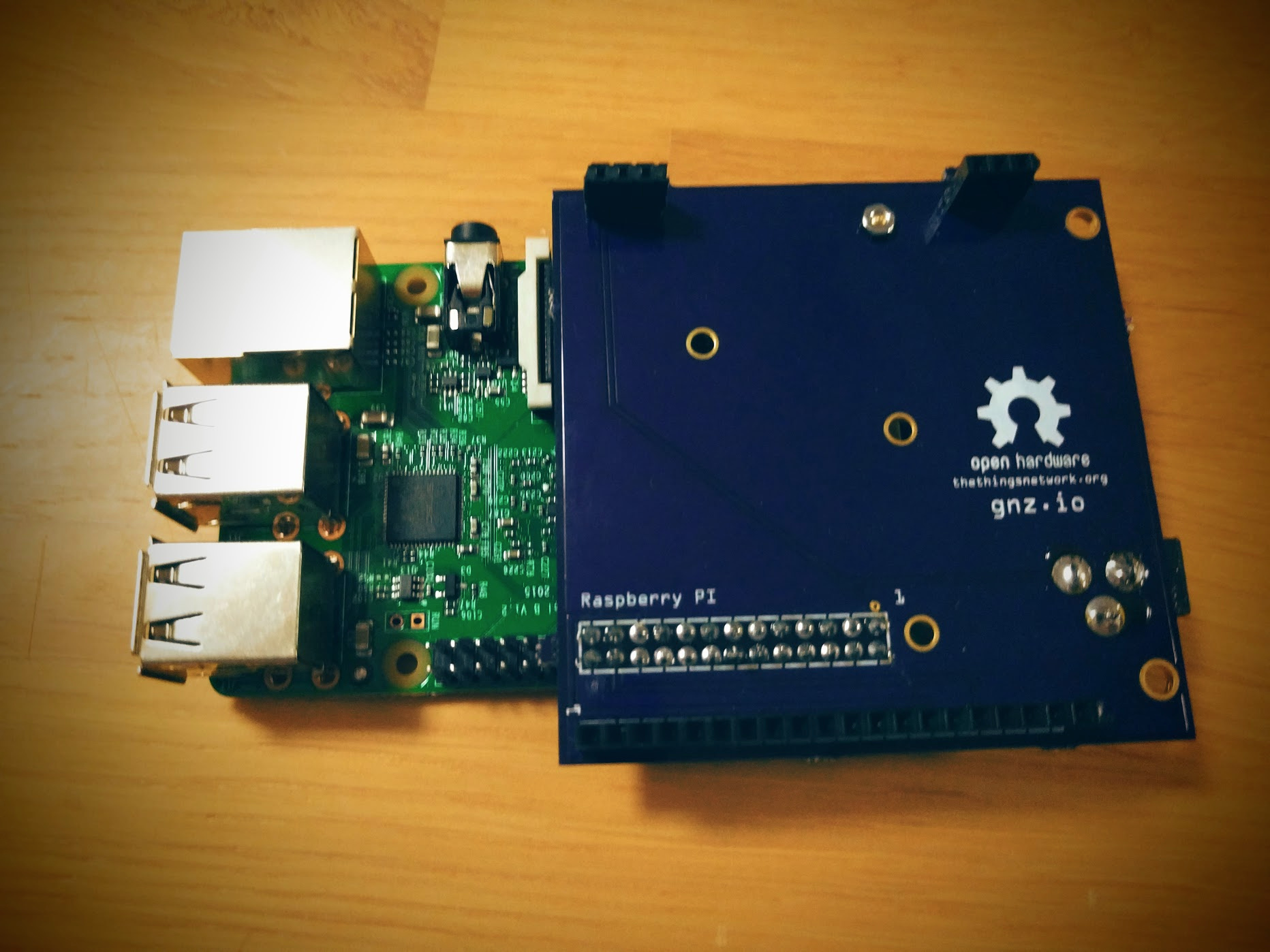

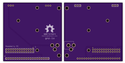

My board doesn’t have any of the funky features of @Charles’ one. It’s as simple as it gets:
It’s shared on oshpark and the Fritzing file is on github.
It works with the installer script without changes.

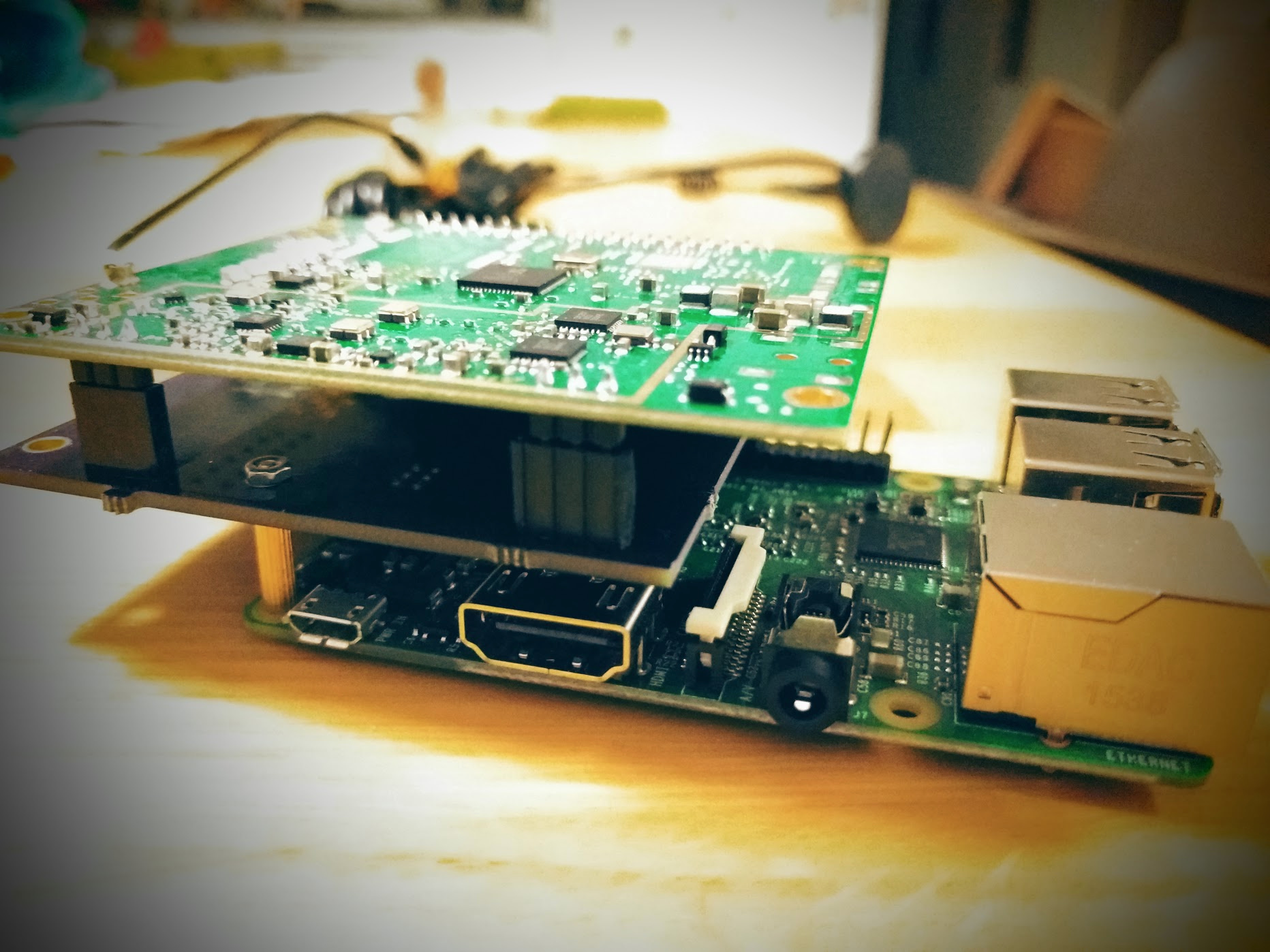

And this is how it looks when plugged to the boards:
